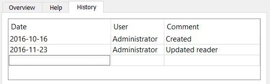

History
Record changes made to the workspace. This is especially good practice if you are sharing data or workspaces.
Example:
Last Save Date, Last Save Build
The History tab also displays the date and FME build on which the workspace was last saved.
