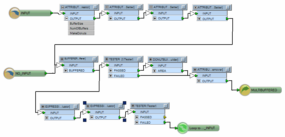

- Create a Custom Transformer in an existing workspace. You might want to include "Loop" in the name. Include the transformers that will make up the conditions of the loop.
- Right-click in the workspace and choose Insert Transformer Loop, or select the menu Insert > Transformer Loop.
- Choose the Input to loop to (if there's more than one). An output appears on the canvas similar to the following:
- Place the transformer in the main workspace and run the workspace. When the looping transformer reaches the preset parameters in the custom transformer properties, the translation will complete.

When you want to set a number of iterations as a transformer's parameter,
you might want to connect the Loop to another input port. In this case,
this input port should not receive any external input features. To do
this, click the properties button of the input port
to open the Edit Transformer Input dialog. Beside the custom transformer name, unclick the Publish checkbox.
Unpublished input ports can be recognized by a small "lock" icon:
In this example, the NOINPUT input port should not receive any features.
