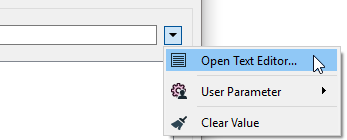

You can define special characters through the Text Editors. Click Open Text Editor from the parameter menu:
Text Editor
Enter characters using the shortcuts from the table above.
Note: To see tab characters, click the Options menu on the bottom left and select Show Spaces/Tabs.
