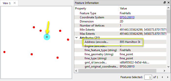

In this example, we have a dataset of Fire Halls, which includes point geometry and some attributes. They have a street address, but not a complete postal address.
We will use a SQLExecutor to join a database table (using the Address field as a key), and retrieve the complete postal address.

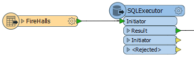

The FireHalls datasets is connected to the Initiator port on a SQLExecutor. Each FireHalls feature will cause the SQL query to be executed, for that feature.

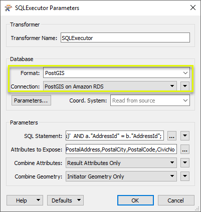

The first step is to connect to the external database. Select the type, in this case, PostGIS. Then configure (or select, if pre-saved) the database Connection.

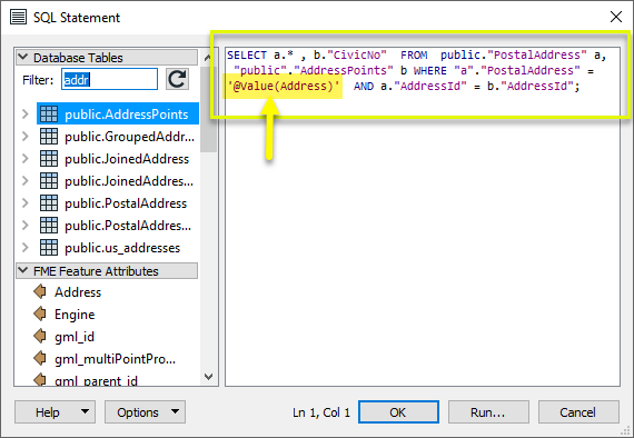

Next we create a SQL statement to join both table. Note:

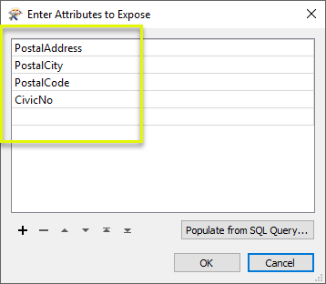

As the attributes will be hidden by default, we choose a set of attributes to expose on our output features.

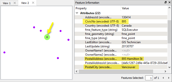

The features with query results are output via the Results port, and have new attributes added by the SQL statement.

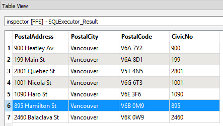

The results for multiple features can be seen in Table View.

Enter the names of attributes to expose on the features created by the query. The attributes will be output in the same sequence as specified in the list. Note: By default, the attributes of the resulting features are hidden. Specify which attributes to expose by entering the attribute names. Click the browse button next to the Attributes to Expose parameter. You can also use a SQL statement to populate the list by pressing “Populate from SQL Query…” and entering a SQL query. The columns from the first matching feature will be used to populate the attributes list. |
