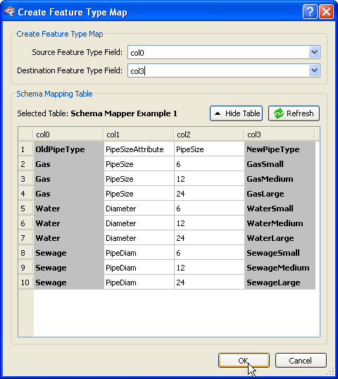

  3. On the Create Actions pane, click Add and select the action type. For this example, we'll select Feature Type Map.
  1. Select the Source and Destination Feature Type Fields. You can show/hide the table columns, and refresh the contents.

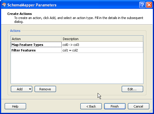

  1. To add another action, select from the Add drop-down menu. In this example, we'll select Filter to display the Create Filter dialog:
  1. Select the table columns in the Attribute Name and Value Fields. By default, Blank Attribute Values are ignored but you can choose to include them.
  2. Click OK to return to the Create Actions dialog. The Action column now shows two actions: Map Feature Types and Filter Features:
  1. Click Finish to set the SchemaMapper parameters.
