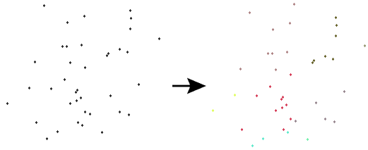

Creates aggregates of features based on their proximity to each other. Each aggregate that is created covers approximately the neighborhood width and height (measured in feature ground units).
This transformer is used to reduce the data volume of "wallpaper" types of features that have no individual attributes. The resulting aggregates can be output to a system using many fewer records than if each feature was output by itself. For systems that support aggregates, or multi-part features, this can result in substantial performance improvements and greatly decrease storage requirements.
Features that leave this transformer will have only the group-by attributes present on them. Any other feature attributes are lost.

These parameters, measured in ground units, divide the input space into cells. The result is a grid of cells that expands in all directions from the origin (0,0). The center of the bounding box of each input feature is used to determine the cell for the feature. Once all input features have been read, an aggregate feature is created from all features in each cell. If linear features are input, they will have pseudo nodes removed from within their cells to further reduce the number of separate entities. No such reduction is done to any polygons or donuts that enter.
Note: To view the grid of cells that is created from these parameters, use the 2DGridCreator. Specify 0,0 for Starting X Coordinate and Starting Y Coordinate, respectively, and the same values for Column Width and Row Height as Neighborhood Width and Neighborhood Height, respectively.
When you set this parameter, neighborhoods with fewer than the specified number of features are merged with a vertical neighbor area in order to increase the number of members. You can prevent this from happening by setting the parameter to 0 (zero).
