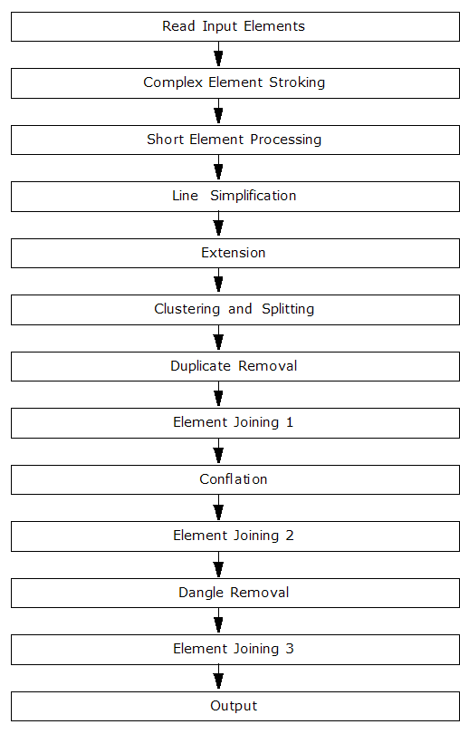

MRFCleaner Modules provide more detailed information on the modules in the underlying MRFCleanFactory.
This
default workflow
is suitable for most situations. However, using the individual modules,
it is possible to create any number of customized workflows for specific
projects and/or datasets (for example, in Workbench, by using a series
of consecutive MRFCleaner transformers or custom transformers). It is
important, however, to understand the data being processed and the desired
end result.
Associated FME function or factory: MRFCleanFactory
