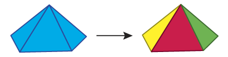

All deaggregated features, as well as features that could not be deaggregated, will be output via this port.
Flatten One Level: this option will break an aggregate feature into child parts one level deep then output each child part as a feature. That is, nested geometries will be deaggregated at the top level.

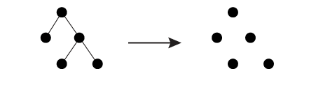

Flatten All Levels: this option will break a nested aggregate into child parts at all levels then output each leaf (a part that has no children) as a feature. That is, nested geometries will be deaggregated recursively and only leaf nodes are output.
Preserve Hierarchy: this option will break a nested aggregate into child parts at all levels then output each part as a feature. That is, nested geometries will be deaggregated recursively and all child parts are output. ID information is added to each output feature to preserve the input hierarchy information.

In Preserve Hierarchy mode, the user may decompose hierarchical geometries and attach either ID and Parent ID, ID and Child ID, or all three sets of ID information. If a hierarchical geometry were to be represented as a tree, then each tree node would have a unique ID. Each node would refer to its parent by Parent ID and its children by child IDs.
The attribute that uniquely identifies each output node feature.
The attribute that identifies a node feature’s parent node.
The list attribute that identifies all child nodes of a node.
