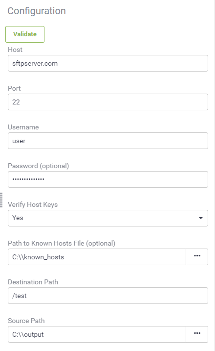

  • Host: The SFTP host name.
  • Port: The SFTP port number. The default is 22.
  • Username: The SFTP user name for authentication.
  • Password: The SFTP user password for authentication.
  • Verify Host Keys: Whether or not to verify the host key for the server connection.
  • Path to Known Hosts File: If Verify Host Keys is Yes, the path to the known_hosts file that contains the public keys for any servers you wish to connect to. If the known_hosts file is saved to a Resources directory, click the ellipsis (...) and select the file. Otherwise, enter the file path directly. File paths must use forward slashes (/) or escaped backslashes (\\).
  • Note: A known_hosts file contains public keys for computers you connect to via SSH. To obtain a public key and insert it into the known_hosts file, run the following command in OpenSSH: ssh-keyscan -t rsa <hostname> > <path_to_known_hosts_file>. Alternatively, contact your system administrator.
    For more information about OpenSSH, and to install, see http://www.openssh.com/.
  • Destination Path: The destination path to upload the file.
  • Source Path: The source file to upload. If the source file is saved to a Resources directory, click the ellipsis (...) and select the file. Otherwise, enter the file path directly. File paths must use forward slashes (/) or escaped backslashes (\\).
