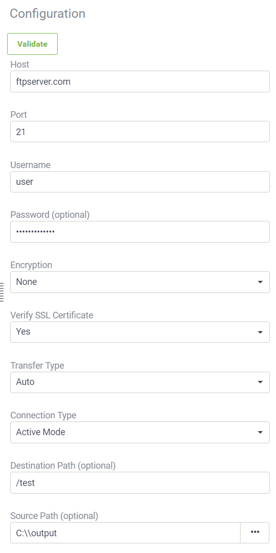

Example Configuration
Mouse-over to view screenshot:
In this example, the source files have been written to {OutputLocation}, as specified in the FILE_DOWNLOAD_SERVICE section of the FME Engine configuration file. FILE_DOWNLOAD_SERVICE is used to configure transformations for the Data Download Service. For more information about the FME Engine configuration file, see Configuration File Layout.
The files are uploaded to the "test" directory of ftpserver.com.
