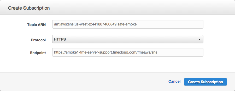

 - Click Create Subscription.
 - Complete the fields in the Create Subscription dialog:
- Topic ARN: Enter the Amazon Resource Name (ARN) of the Amazon SNS topic you wish to subscribe to. You may need to contact the topic owner for the Topic ARN.
 - Protocol: Select HTPP or HTTPS based on your FME Server web address.
 -  Endpoint: Enter the web address of the FME Server Amazon SNS Publisher. For example,
https://dev.fmeserver.com/fmeaws/snsorhttp://myhostname.fmecloud.com/fmeaws/sns.

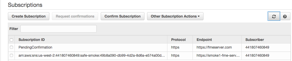

 - Click Close. The new subscription appears under Subscriptions with “PendingConfirmation” as the Subscription ID.
 - Complete the subscription process by clicking the Refresh button. “PendingConfirmation” is replaced with an identifier for your subscription.
Assuming you provided the correct endpoint and FME Server is running, the Amazon SNS publisher automatically confirms the subscription.
