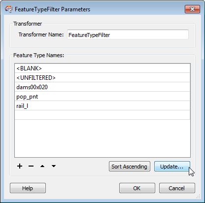

After connecting feature types to the Input port of the FeatureTypeFilter, open the transformer parameters and click the Update button at the bottom right. (You can also type names in the Feature Type Names field.) FME analyzes the workspace and determines the possible input feature types.
The Update button is enabled only if you are in the main tab and have an input feature type attached to the FeatureTypeFilter transformer. The Update button will then read the feature types on the connected reader and automatically populate the Feature Type Names list with those values.
Click Update again and FME creates the corresponding output ports for every new connection.
