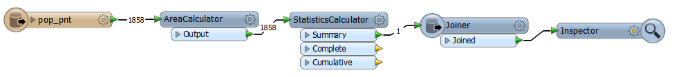

When a log file shows a translation that ended in an error, or where the number of output features was not what you were expecting, then the Feature Count values shown on each connection can help diagnose where the error occurred.
However, different interpretations can be placed upon the same numbers.
In this example, when we run the workspace, it fails:
Where does the failure occur?
The feature counts are open to two interpretations:
- 1858 features entered the StatisticsCalculator, but only 1 emerged. Therefore the StatisticsCalculator must be at fault.
- The first feature caused the Joiner to fail. Therefore the Joiner is at fault.
It may not be entirely clear where the problem occurred, but at least you can narrow it down and be fairly certain that the reading of the data and the AreaCalculator are not the locations of the problem.
