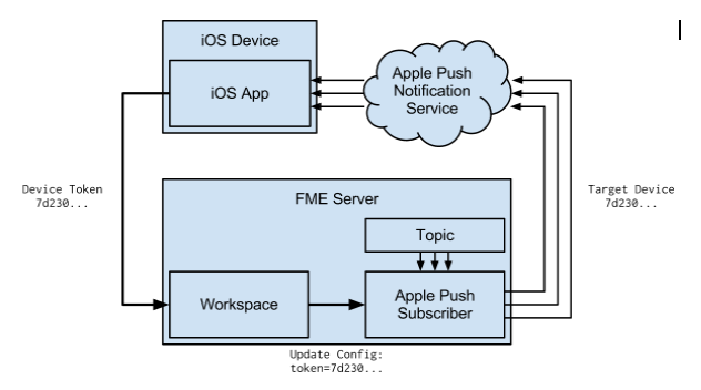

Acquiring the Device Token for the Target Device
Each iOS device can register itself to the Apple Push Notification Service, and when doing so, associates itself with a device token, which is a 64-digit hexadecimal number that uniquely identifies the iOS device.
The iOS app on the device must distribute its device token to FME Server. Typically, the device token is sent to a processing workspace on FME Server that records the token and updates the subscriber. This flow is illustrated below.
An iOS app can register to the Apple Push Notification Service using method registerForRemoteNotificationTypes: , and the device token is returned in the app delegate method application:didRegisterForRemoteNotificationsWithDeviceToken:. This process is described in Registering for Remote Notifications.
