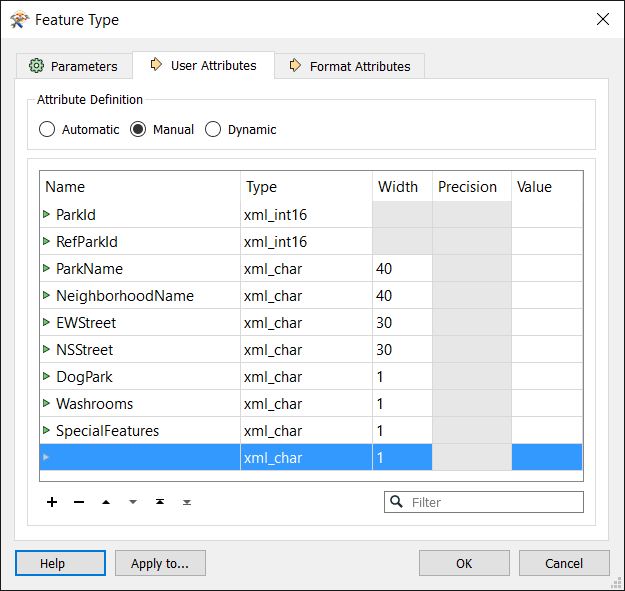

How to add a new attribute to a feature type:
- Select the Writer Feature Type, right-click and select Add Attribute. (You can also click the gear icon and the User Attributes tab.)
- Enter the name of the attribute and use the tab key to move through the Data Type, Width and Precision fields. You can enter or change the default values provided in these fields, or continue to enter more attribute names.
- Click OK.
- Connect the attribute with its source.
