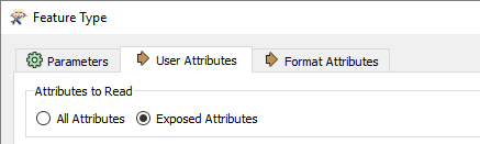

Attributes to Read
Note: These options are not available for all formats.
These options allow you to specify the attributes that are read when the workspace is run. Limiting attributes that are read can improve performance, reduce memory consumption, and make workspaces less cluttered.
- All Attributes – Read all the attributes found in the source data when the workspace is run. The attributes read can differ from those displayed under 'Attribute Definition' (see below).
- Exposed Attributes – Read only the attributes that are checked in the Exposed column in the Attributes Definition table.

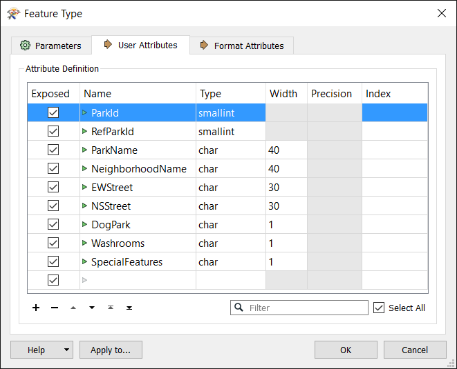

This table shows the structure of the source data, including attribute names and their types.
Attributes that are checked under Exposed are shown on the canvas and can be referenced from downstream transformers and writer feature types. Additionally, the structure of the source data can be duplicated on a writer feature type through various options including: Copy from Reader… in the Add Writer dialog, Duplicate on Writerfrom the reader feature type's context menu, and Copy Attributes From Feature Type from the writer feature type's context menu.
Unchecked attributes are hidden in the workspace, but are still read at runtime, unless 'Attributes to Read' is set to Exposed Attributes.
This table automatically populates when you add a new reader. If the structure of the source data has changed or is no longer current, you can update it through the menu Readers > Update Feature Types.
For advanced scenarios, you can enable the ability to edit the Attribute Definition table. To activate this ability, click Tools > FME Options > Workbench > Allow reader feature type editing.
Note: Some readers do not support editing the Attribute Definition table, regardless of this setting.
