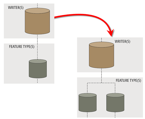

However, in most cases you need to manage Writer feature types separately, because what you want from the Writer is not the same as what you have in the Reader. For example, if you want to divide an incoming layer of data into two layers in the output dataset, you will need to add a new Writer feature type.
Adding a Writer feature type manually has this effect on the hierarchy diagram. Your output was designed to have only a single layer; now it will have two.

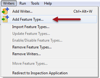

Feature Types can be added manually to a writer using Writers>Add Feature Type on the menubar.
At least one writer must exist in the translation hierarchy; else this option will be greyed out.
Selecting Add Feature Type places a feature type object on the workspace, and then opens the Feature Type dialog so you can edit the feature type's properties.

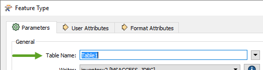

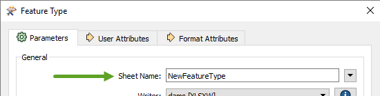

Similar to editing the schema, the Parameters tab can be used to define the new feature type’s name.
Feature Type names use format-specific terminology, so the label might be Feature Class, Layer, Sheet Name, Table Name, or whatever terminology is specific to the format of data you are writing: |

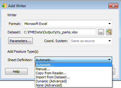

When you are adding a new Writer, you can also control the feature types that are added to the workspace:
There are six options for adding feature types:
- Automatic: Adds a new feature type with the attribute definition parameter set to automatic. This is the default.
- Manual: Adds a new feature type with the attribute definition parameter set to manual.
- Copy from Reader: Adds a new feature type with the attribute definition parameter set to manual, but predefined to the schema of an existing Reader feature type.
- Import from Dataset: Adds a new feature type with the attribute definition parameter set to manual, but predefined to the schema of an external dataset (just like using the Import Feature Types tool).
- Dynamic: Adds a new feature type with the attribute definition parameter set to dynamic.
- None: Does not add any new feature type.

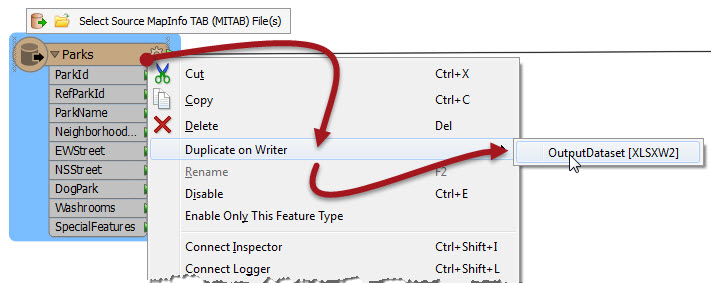

When adding a Writer it's possible to create a new feature type whose attribute schema is pre-defined to that of an existing Reader. However, if you already have a Writer, you can still carry out the same procedure of copying a Reader schema. This is simply done by selecting the required Reader feature types, right-clicking them, and using the option Duplicate on Writer.
The command causes duplicates of the Reader feature types to be added to the writer, and source/destination feature types to be automatically connected.
