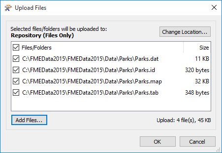

The file path indicates where any resources currently reside in your local folder. In this example, Workbench has identified four resources associated with the workspace:
To add or remove files and folders from being uploaded, check or clear their respective check boxes. To add more files, click Add Files.
At the top of the dialog is indicated where the files are uploaded in FME Server. In this example, the files are uploaded to Repository, which means the repository specified in the Publish to FME Server dialog.
To change the upload location, click Change Location.

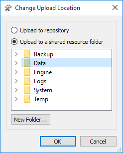

Upload to repository: The files associated with the resource are uploaded to the repository you specified in the Publish to FME Server dialog. The files are available only to workspaces in the same repository.
Upload to a shared resource folder: The files associated with the resource are uploaded to a shared resource folder that is preconfigured in FME Server. This is the preferred location for storing data files for use in FME Server. Files in shared resource folders are available to all workspaces on the Server, regardless of repository.
Specify the shared resource folder in which to place the files. The Data folder, or any of its subfolders you may have created in FME Server, is the preferred location.
To create a new subfolder in which to upload the files, select an existing folder and click New Folder.
