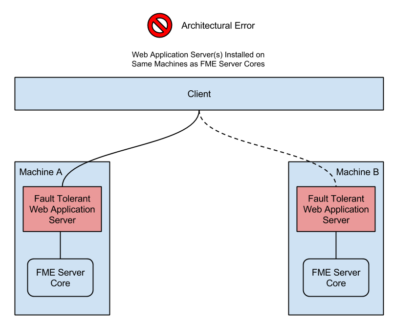

 Can I install separate FME Server Web Application servers on the same machines as the FME Server Core machines?
                                            This configuration is not supported because:
- Clients connecting to the Web Application Server may be unable to choose the proper one.
- After a failover, the FME Server Web User Interface cannot be used to submit jobs, because the service URL patterns (stored in the FME Server Database) point to the Web Application Server on the pre-failover machine.

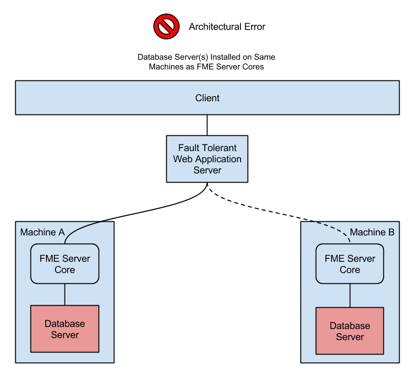

 Can I install separate servers for the FME Server Databases on the same machines as the FME Server Core machines?
- The failover Core is unaware of workspaces published to the primary Core.
- The failover Core is unable to resume processing the job queue.
