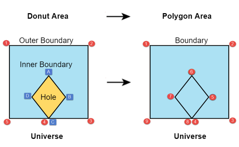

If set to Yes and if Attempt Repair is set to Yes, then donuts that have a hole touching the outer boundary will have the hole added to the outer boundary. This will convert the outer boundary to a pinch polygon. This option will only affect donut holes touching the original outer boundary. The donuts that have been repaired may become donuts without holes, and thus become degenerate.
| The example diagram below illustrates a donut with a hole touching its outer boundary on the left (Donut Area). The hole is added to the outer boundary of the donut as shown on the right (Polygon Area). The donut nodes are shown in the red numbered sequence while the hole is shown in the blue alphabetical sequence. |
