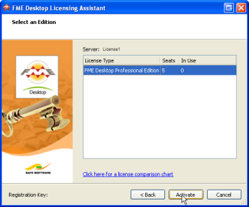

- Select the license type from the list, and click Activate.
- Click Finish.
