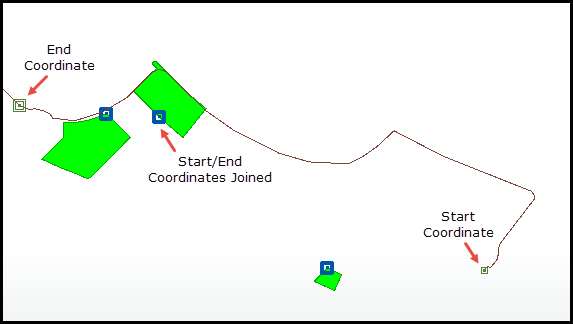

You can mark the starting and ending coordinates of features that appear in the View Window in 2D mode. You can view starting and ending coordinates of line, arc, path, polygon, and donut geometries.
Note: To view all coordinates of a geometry, and not just the starting and ending coordinates, see Viewing Coordinates and Text Insertion Points.
There are three types of markers:
  • Square with center point: The starting coordinate of a geometry.
  • Two squares with center point: The ending coordinate of a geometry.
  • Thick square with center point: The starting and ending coordinates of a geometry that are joined together (that is, they are the same value).
In this example, the starting and ending coordinates that comprise parks and a bicycle path are marked:
