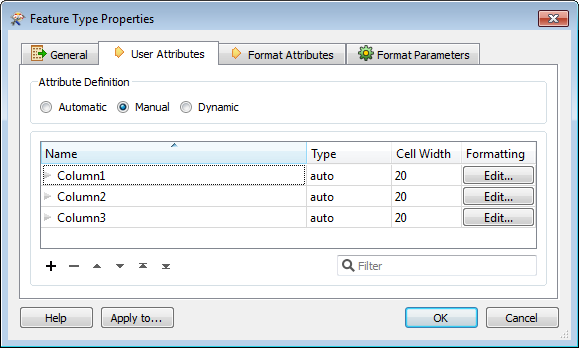

To access user attributes, click the properties
button on a feature type in the workspace, and select the User Attributes tab.
User attributes for this format are defined below.
