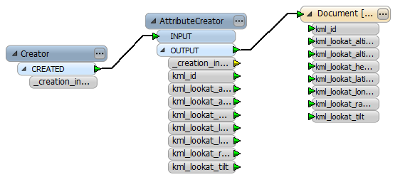

To set the LookAt element in Workbench for a KML document written by FME, you need to write a "document" feature that overrides the root document. To do this, follow these steps:
  1. Open a blank workspace.
  2. Place a Creator transformer, and create a new feature.
  3. Route the new feature through an AttributeCreator transformer to the writer feature type (you might have to create a new writer feature type when prompted).

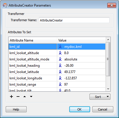

  4. Create the following attributes in the AttributeCreator:
Attribute Value AttributeCreator Example
kml_id The value must match the filename of the destination dataset (that is, if you are writing to mydoc.kml, the id should be mydoc.kml) . If the kml_id does not match, a second document will be created.
kml_lookat_longitude (required) Maps to the <longitude> element of <LookAt>
kml_lookat_latitude (required) Maps to the <latitude> element of <LookAt>
kml_lookat_altitude Maps to the <altitude> element of <LookAt>
kml_lookat_altitude_mode maps to the <altitudeMode> element of <LookAt>
kml_lookat_heading Maps to the <heading> element of <LookAt>
kml_lookat_tilt Maps to the <tilt> element of <LookAt>
kml_lookat_range Maps to the <range> element of <LookAt>

The finished workspace should look like this example:
Save and run the workspace to generate the mydoc.kml file.
