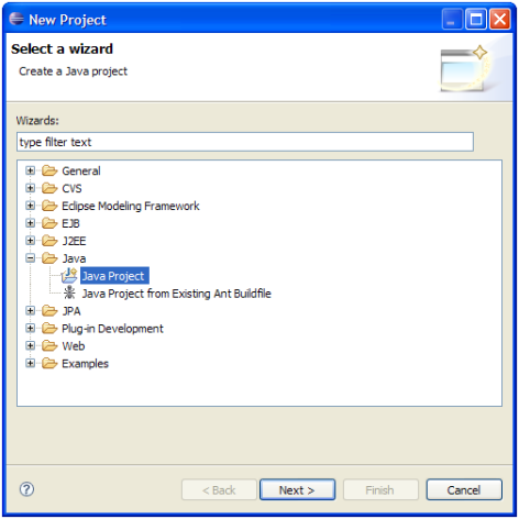

  6. Start Eclipse.
  7. Choose File > New > Project, and select Java Project.
  8. Enter FMEServerWebServicesDemo for the project name.

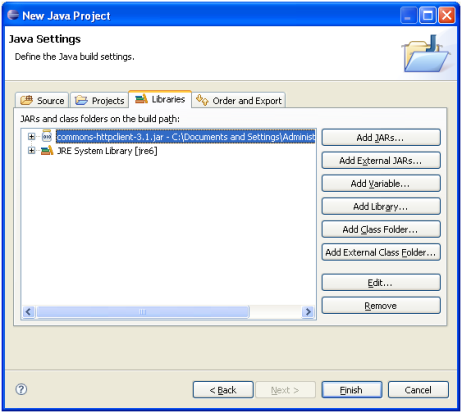

  9. In the Java Settings dialog under the Libraries tab, click on Add External JARs button.
  10. Select the commons-httpclient, commons-codec, and commons-logging JAR files in the Apache HTTP Client lib folder to add to your project.
  11. The names may be different depending on version. You may also select all JARs in the folder.
