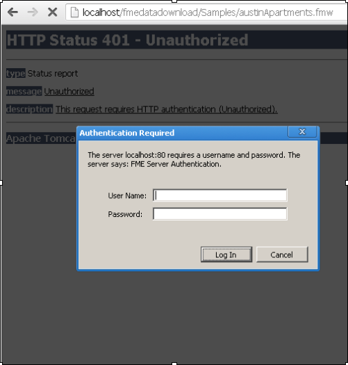

Now, when you try to access the data download service, you are prompted for credentials.

  3. If you now try access the data download service (http://localhost/fmedatadownload/Samples/austinApartments.fmw), it requires authentication because the guest user that the data download service uses to authenticate is no longer assigned to a role.
