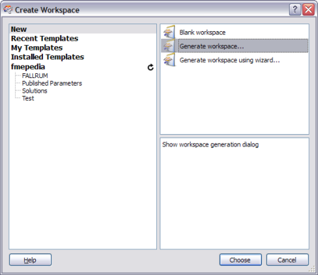

  3. Create a new workspace by selecting File > New.
  4. In the Create Workspace dialog, select Generate workspace and click Choose.

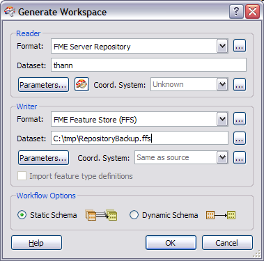

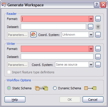

  5. The Generate Workspace dialog opens.
  6. Select FME Server Repository as the Reader Format, and click the Reader Parameters button to display the Repository parameters dialog.
  7. Enter the information required to connect to a running FME Server, and then click OK.
  8. Select FME Feature Store (FFS) as your Writer Format, and enter a Writer Dataset file path to the FFS file where you want to store the backup.
  9. Click OK.

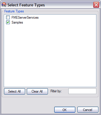

  10. The Select Feature Types dialog opens.
    Each feature type represents an FME Server repository. The FMEServer Services feature type contains the workspace service registration information, which you should keep, in most cases.
  11. Select the feature types (repositories) you want to export, and then click OK.
  12. The initial workspace opens.
    Note:  When the workspace is created, you can still remove repositories that you do not need to export. Select them in the workspace, and then click Delete.
