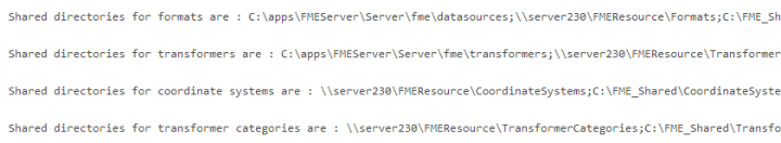

To verify that the new directories are recognized by FME Server, run any job, using the Job Submitter service, and view the log. Look for entries similar to the following:
Note:  If there are two definitions of the same custom transformer, one in the repository directory and the other in the shared directory, FME Server tries to find the transformer in FME_SHARED_RESOURCE_DIR first and use that. If it is not there, it looks for the transformer defined in the resource directory.
