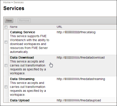

To enable SSL for a service, open the FME Server Web User Interface, click Services, and click the desired service in the table.
The Editing Service page opens.

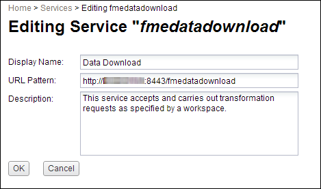

In the URL field, change HTTP to HTTPS, and modify the port number, if required. Typically SSL is configured on either port 8443 or 443.

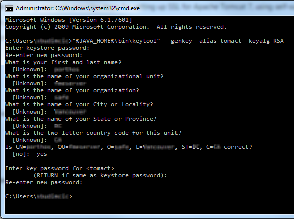

  1. Open the command prompt.
  2. Type the following command:
    keytool -genkey -alias tomcat -keyalg RSA
    If your path is not set to the Java bin directory, navigate to that directory and type the appropriate command.
    Note:  A JDK must be installed to use the keytool command.
    A message prompts you to enter a keystore password.
  3. Enter a password for the keystore.
  4. Enter the required details, shown here:
    A message prompts you to enter the alias password, which must be the same as the keystore password.
  5. Enter the same password you entered in step 3.
