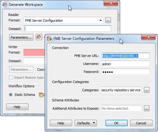

  3. Select FME Server Configuration as the Reader Format, and click the Reader Parameters button to display the FME Server parameters dialog.
  4. Enter the information required to connect to a running FME Server.
  5. Specify the FME Server configuration categories to read. FME Workbench reads these "categories" as "feature types." Click OK.

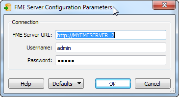

  7. Click the Writer Parameters button to open the Repository Parameters dialog.
  8. Specify the information required to connect to your running FME Server, and then click OK.
