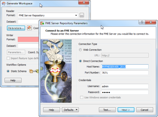

  3. Select FME Server Repository as the Reader Format, and click the Reader Parameters button to display the Repository parameters dialog.
  4. Enter the information required to connect to a running FME Server, and then click Next.

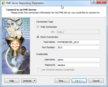

  7. Click the Writer Parameters button to open the Repository Parameters dialog.
  8. Specify the information required to connect to your running FME Server, and then click Next.

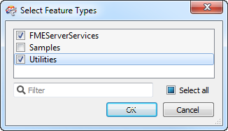

    This causes the Select Feature Types dialog to open. Each feature type represents an FME Server repository (except for the one named FMEServerServices, which contains metadata related to FME Server services).
  12. Select the feature types (repositories) that you want to migrate, and then click OK.
    When the workspace is created, you can still remove repositories that you do not need to import. Select them in the workspace, and press the Delete button.
