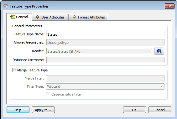

Above: The Feature Type Properties dialog has a number of tabs that display information. Click the General tab to view the name of the feature type. In the example above, the feature type name is States. Permitted geometry types are shown here, as well as the name of the parent dataset for the feature type.

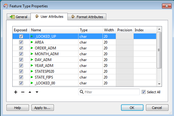

Above: The User Attributes tab shows a list of attributes present on the feature type. Each attribute is defined by its name, data type, width, and number of decimal places.
This example shows a reader feature type. (Editing reader feature types is advanced FME function, suitable mainly for testing purposes.)
You can edit the attributes on a writer (destination) dataset to create the required output.
The Type column for an attribute shows only values that match the permitted types for that data format. Click the row to see the permitted types for an attribute:
