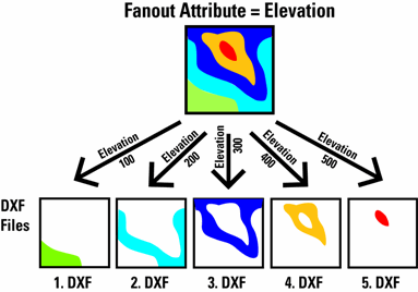

Dataset Fanout
A dataset fanout divides the data and writes a different dataset for each division. In this example, data is divided up into a number of datasets on the basis of an elevation attribute.

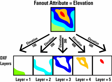

Feature Type Fanout
A feature type fanout writes a single dataset but divides the data into a number of layers/themes/feature types/objects/classes in that dataset. In this example, data is divided into a number of layers on the basis of an elevation attribute.
