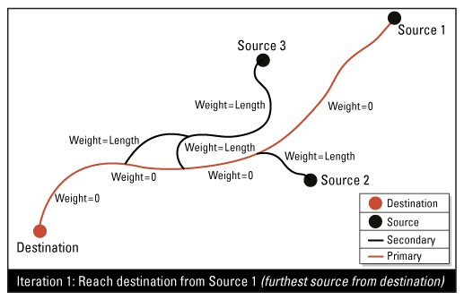

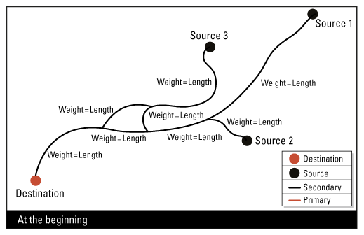

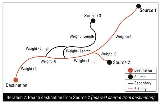

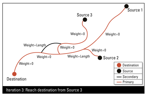

This attribute defines, for each source junction of the network, a unique path (the shortest path) to reach the destination junction. All flow lines included in a path (from the sources to the destination) will have a stream priority attribute set to 1 (primary); all others are set to 2 (secondary).
Before using this transformer, you will need to specify the weights on the network lines in the source data by specifying the Forward Weight Attribute and optionally Reverse Weight Attribute if the network graph is non-oriented.
A weight is a property of a network line typically used to represent a cost for traversing across a network line. An example of a line weight is the length of the line. In a shortest path analysis, you would choose this weight if you wanted the resulting path to be of the shortest length. For line features, 2 weights can be used: one along the digitized direction of the line feature (the forward weight) and one against the digitized direction of the line feature (the reverse weight). The digitized direction of a line feature refers to the order of the vertices.
The goal is to flag the loops (cycles) in the network in order to highlight the primary network lines.

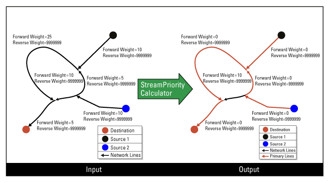

Calculating the Stream Priority for Oriented Network Lines
When the network lines are oriented, the shortest path should not go against the digitized direction. So initially the weight along the digitized direction (the forward weight) is the length, and the weight against the digitized direction (reverse weight) is a bigger value.
Note that the reverse weight is optional, and usually not required.
Calculating the Stream Priority for Non-Oriented Network Lines
When the network lines are not oriented, the digitized direction of network lines is not significant. So the weight along the digitized direction (forward weight) and the weight against the digitized direction (reverse weight) are the same. In this case, you can use the same attribute corresponding to the length for both weight parameters. In this way, the loops are removed for the primary network lines (stream priority=1) and you can apply other algorithm to modify the digitized direction. This is how you can make network lines primary (stream priority=1) where the digitized direction represents a downstream flow direction.
