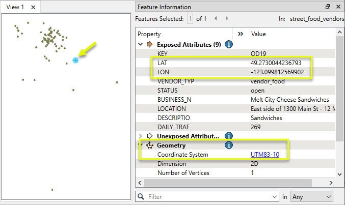

In this example, we have a shapefile of food vendor locations, and want to generate MGRS codes for each location.
Note that although the dataset is in a UTM coordinate system with ground units in meters, it also has a set of coordinates, latitude and longitude, stored as attributes.

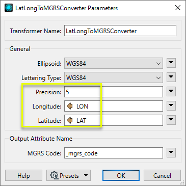

The features are routed into a LatLongToMGRSConverter.
In the parameters dialog, Precision is set to 5, and the Longitude and Latitude parameters are set to the appropriate attributes.

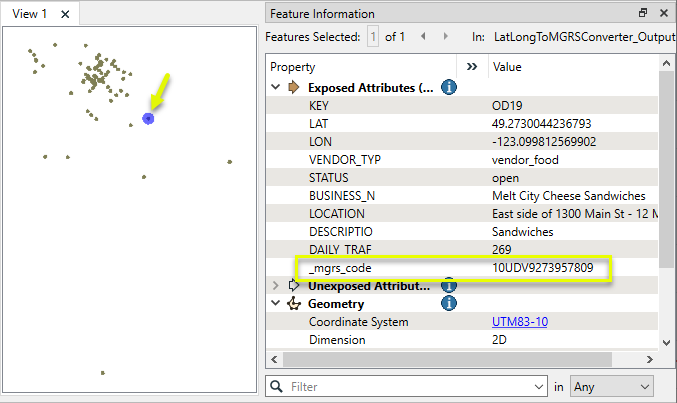

The output features have a new attribute containing the resulting code.
