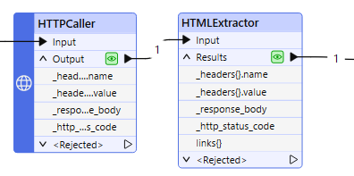

In this portion of a workspace, all of the links on a web page will be extracted and output as a list attribute.

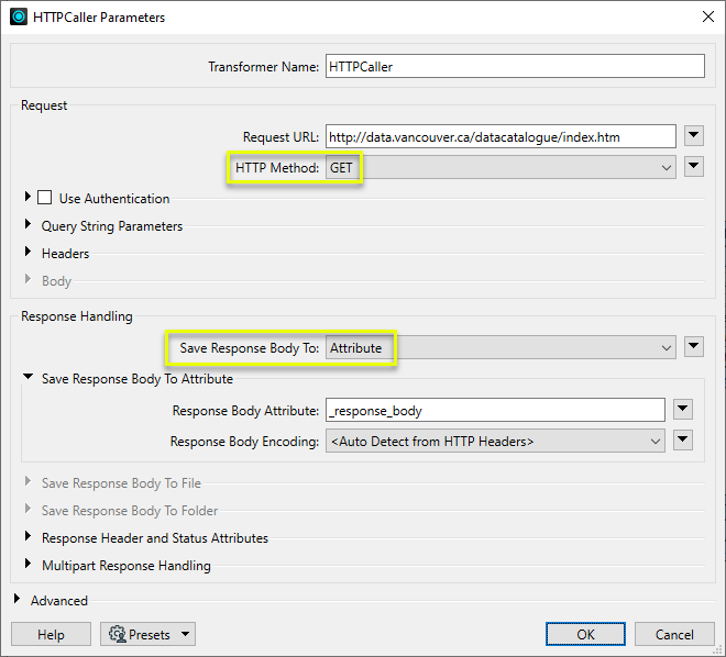

An HTTPCaller retrieves the contents of a web page, using the GET method. The contents of the page are stored as HTML in the _response_body attribute.
In the HTMLExtractor, the same attribute is set as the HTML source, and a query is constructed to find all links (CSS Selector = a[href]), extract the only the link itself (Tag Part/HTML Attribute = href), and store that in a new attribute called links.
The Return Format is set to List Attribute, and so all matches will be included.
The output will look similar to this:
links{0} = ‘https://www.example.com/page1.html’
links{1} = ‘https://www.example.com/page2.html’
links{2} = ‘https://www.example.com/page3.html’

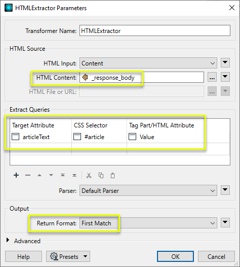

In this portion of a workspace, an HTTPCaller uses the GET method to retrieve the contents of a web page and store them in the attribute _response_body.
In the HTMLExtractor, a query is constructed to find the div tag with the id “article” (CSS Selector = #article). The contents of that tag will be extracted (Tag Part/HTML Attribute = Value), and output to the new attribute articleText.
With the Return Format set to First Match, the contents of the first matching div tag encountered will be output as an ordinary (non-list) attribute.
