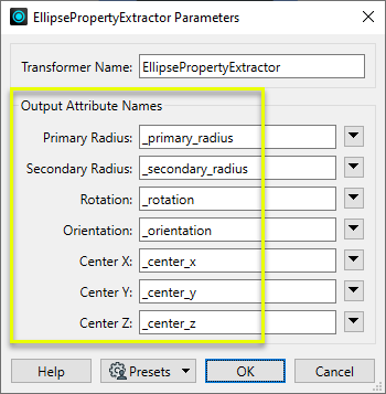

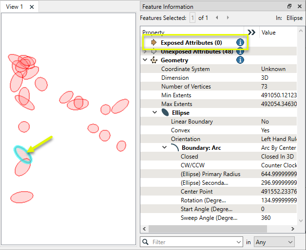

In this example, we have a set of features with various ellipse geometries and want to extract the properties into attributes for use elsewhere.
Note that the input features have no attributes, but do have geometry properties.
The features are routed into an EllipsePropertyExtractor.

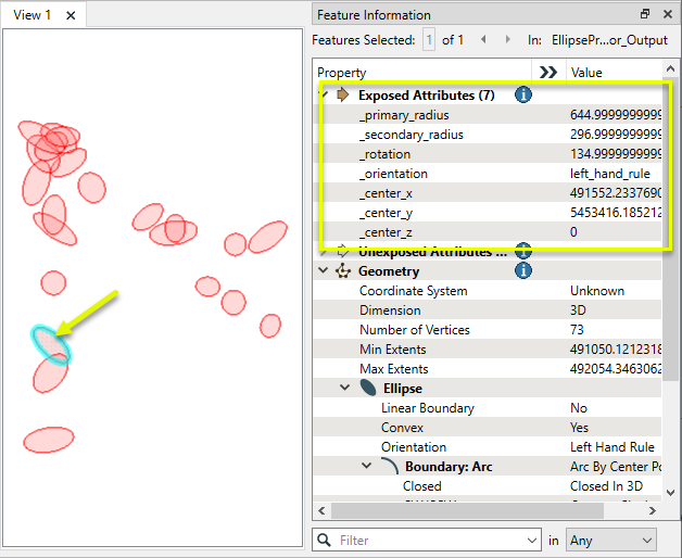

In the parameters dialog, we keep the defaults given for all Output Attribute Names.
The output features have new attributes added, containing the geometry properties.
