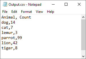

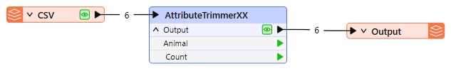

In this example, we start with a CSV file containing animal names and counts. Some animal names have varying numbers of extra spaces that need to be removed.
All features from the CSV file are routed into an AttributeTrimmer.

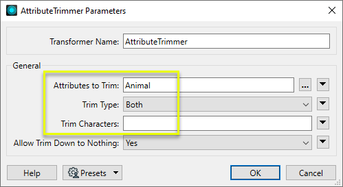

In the Parameters dialog, we select the attribute Animal for trimming, choose Trim Type Both to trim both the left and right-hand sides of the values, and leave the Trim Characters field blank - indicating we want white space removal.
The resulting output has clean Animal values, with spaces removed.

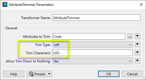

In this example, we start with a list of codes. They are all prefixed with the string UID-, and we wish to remove that prefix from the values.
The features are routed into an AttributeTrimmer with the intention of removing the prefix.
In the Parameters dialog, we select Trim Type as Left (the location of the prefix), and enter the prefix string UID- as the Trim Characters.
In the output file, the prefixes have been removed - but unfortunately, some additional characters have been trimmed as well. Because the AttributeTrimmer is not looking for a specific pattern of characters, if the first character(s) to the right of the prefix match any characters in the Trim Characters string, they will be removed as well.
As highlighted in the CorrectResults list, some of the initial characters beyond the prefix matched the Trim Characters.
A better choice to perform this task would be the StringReplacer, which will look for the exact pattern of the prefix.

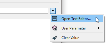

Defining Special CharactersYou can define special characters through the Text Editors. Click Open Text Editor from the parameter menu:
Text Editor Enter characters using the shortcuts from the table above. Note To see tab characters, click the Options menu on the bottom left and select Show Spaces/Tabs.
