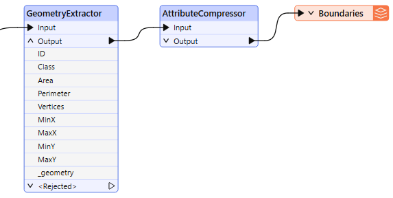

In this portion of a workspace, an input dataset with complex boundary polygons is to be loaded to a non-spatial database.

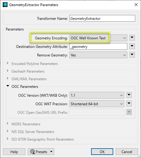

The first step is to extract the geometry and convert it to an attribute with the GeometryExtractor. Having selected WKT as the encoding type, the geometry is stored in the new attribute _geometry.

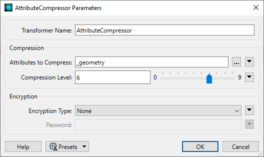

The features are then passed to the AttributeCompressor to optimize them for storage prior to writing to the database.
The features are then sent to the database writer, where the compressed attributes will be written as blobs and stored.

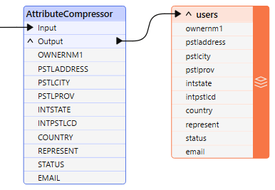

In this portion of a workspace, a table of owners is written to a database.

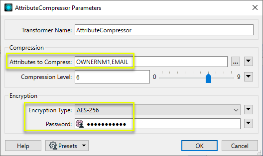

Using the AttributeCompressor, the names and email addresses are password-encrypted for an added layer of personal information protection in the database.
In this example, the password is being created by a published user parameter that the user can assign as the workspace is run.
