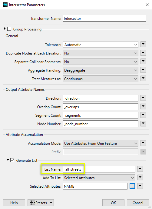

Set up a workspace that routes all the street centerlines into an Intersector transformer. Adjust the parameters of the Intersector to supply a list name (for example, all_streets).
Let's assume that the input street lines had an attribute called NAME.
Now, among
other things, the Node output of the Intersector will have an unqualified
list on it called all_streets{}.NAME
. This
list will hold the names of all the streets that intersect at each particular
point (or Node) that is output.

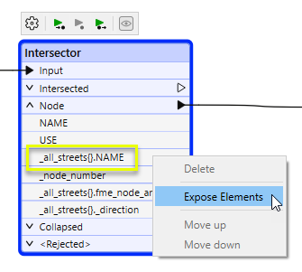

Expose Elements
Note that you can also access the individual street names by "exposing"
some elements of your list: right-click on the attribute unqualified
list name (in our example, all_streets{}.NAME
and select Expose Elements.
In the Select List Elements dialog, enter the number of elements to expose. (The disadvantage to this approach is that you need to know ahead of time how many list elements you want to work with.)
