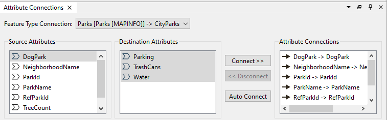

In the Attribute Connections Window, select the applicable Feature Type Connection, then select the Source Attributes you want to connect (Shift+click to select multiple lines at one time, or Ctrl+click to select individual sources). Select the Destination Attributes to which you want to connect the selected Source Attributes.
Click the Connect button.

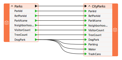

The attributes are connected in the workspace:

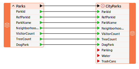

To quickly delete connections from the workspace: Click directly on one connection and press the Delete key, or hold down the Ctrl key and click numerous connections. To quickly select many connections, hold down the left mouse key, drag the cursor around an area, release the mouse button, and press the Delete key.
