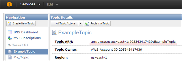

- The Amazon Resource Name (ARN) for the topic to be published to.
Assuming you are the topic owner, you can find the Topic ARN by navigating to your topic through the AWS Management Console (see below). Otherwise, ask the topic owner for the Topic ARN.
