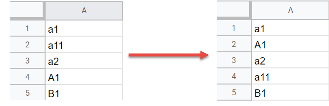

Note: Unless Sort Alphabetical or Sort Numerical is explicitly specified, sorting is Natural. That is, Data Inspector sorts according to the values in the column, rather than the column data type. The following example shows how a column containing a mix of letters and numbers is sorted in ascending order (Sort Natural Ascending):
