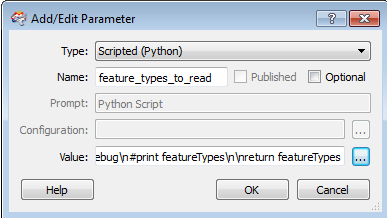

In the Workbench Add/Edit Parameter dialog, the parameter is defined using the following options:

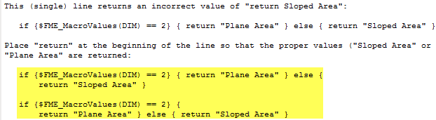

Note: For both Python and Tcl, your code must contain a return statement on the last line of code. If there is no return statement (and assuming there is more than one line of code) FME will add return to the beginning of the line. Example for single lines of code:Closed
When finding the last line of code, multiline statements or comments are not supported.

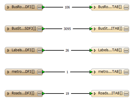

If you Select All, the features are set to all feature types:

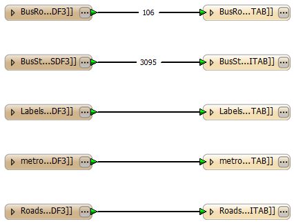

If you select Bus Information only, for example, the feature types are set to Bus Routes and BusStops only:
