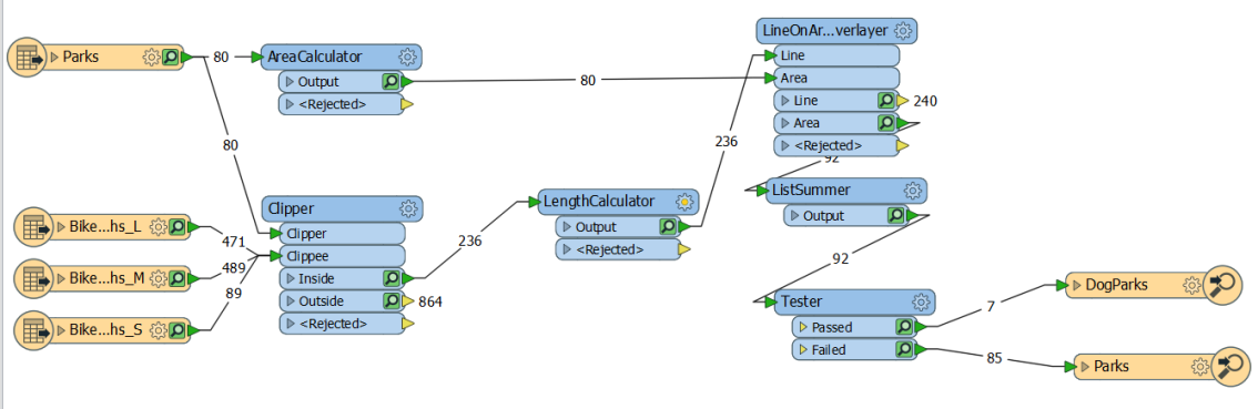

This option seamlessly integrates the workspace with the Data Inspector. When enabled, output ports record features in temporary caches, which you can view and inspect after a translation is finished. With feature caching, you can choose to run the entire workspace, or a portion of it.
Note: This mode is particularly useful when you want to see where (and how many) features are flowing in the workspace, and for workspace debugging. However, this mode affects system resources, and, because all features are recorded and stored, it can also affect disk space. For these reasons, you may not want to run all workspaces in this mode.
This example workspace shows the canvas after running with feature caching:
To view recorded features, click an inspection icon on an output port ().
The features output at that port are presented in the Visual Preview pane or the FME Data Inspector, depending on your Data Inspection settings in Tools > FME Options > Workbench.
To show features from multiple output ports, select one or more objects, right-click, and select Inspect cached features.
