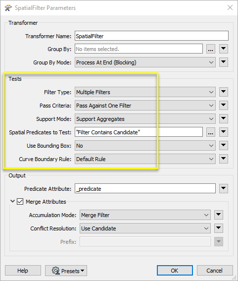

In the SpatialFilter parameters dialog, we make the following selections:
- Filter Type: Multiple Filters. There are multiple building polygons that we want to test against.
- Pass Criteria: Pass Against One Filter. Each address point only needs to fall inside one polygon - not all of them.
- Spatial Predicates to Test: Filter Contains Candidate. We want to check if each Candidate (address point) falls within a filter (building polygon).
These are the key parameters - the others are left as default for this example.
