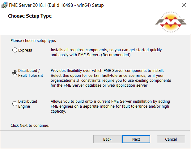

Choose Setup Type
Select the Distributed/Fault Tolerant install option.
Custom Setup
Select FME Server Core Components and FME Engine. Do not select FME Server Database or Web Services. (Optionally, select Console. For more information, see FME Server Console.)

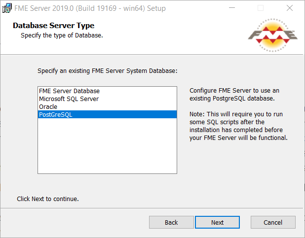

Database Server Type
Specify the type of database for the FME Server Database. If you installed the PostgreSQL database included with the FME Server installer, select FME Server Database. If you are configuring the FME Server Database on your own database server, select the database server type: Microsoft SQL Server, Oracle, or PostgreSQL. For more information, see Provide a Database Server.
Database Server Parameters
Specify the connection parameters for the FME Server Database.
Note: If Oracle was specified in the previous dialog, you must check Use Custom JDBC Driver and specify the JDBC Driver.
