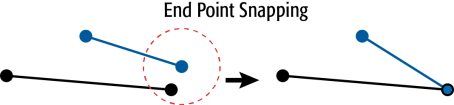

When this parameter is set to End Point Snapping, the transformer:

Snapping Distance specifies the distance, in ground units, that the snapping occurs between features.

The example below illustrates end points of two line features snapping together.
