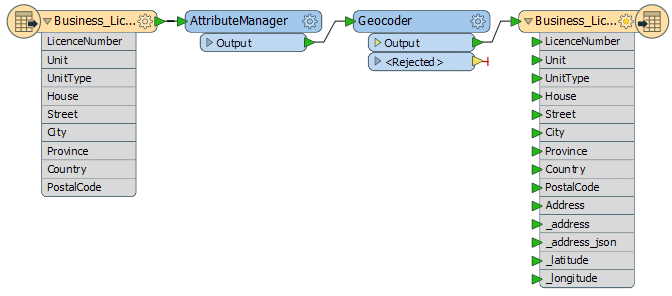

In this example, a spreadsheet containing a list of businesses, with address components spread over a series of columns, is geocoded and output to KML.

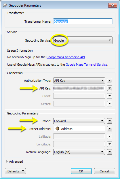

The geocoding will be done using the Google service, which expects to see addresses in a free-form single attribute, so a new attribute - “Address” - is created using the AttributeManager. This new attribute contains the complete address, with components separated by commas:
In the Geocoder, selecting Google as the Service brings up their required parameters. The API key provides authentication, the default geocoding mode of “Forward” is selected, and the Street Address is set to the newly constructed “Address” attribute.

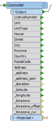

Expanding the Output on the Geocoder now shows the additional attributes available from the service - some of which have been included in the KML writer, as indicated in green. And though we have chosen to include latitude and longitude as attributes, point geometry is also being created for the features (regardless of whether or not the information is retained as an attribute, as done here.)

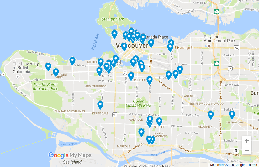

The results are output to a KML file.
