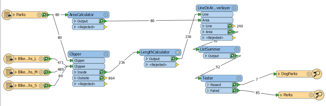

This example workspace shows the canvas after running with feature caching:
To view recorded features, click an inspection icon on an output port ().
